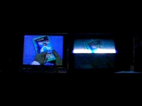

CRT Versus LCD
This video, from a high-speed camera, compares an LCD and a CRT display slow-motion.
  • The LCD display is continuously illuminated even during refreshes.
  • The CRT display is only illuminated for a short period during refreshes.
On this specific CRT, the phosphor decays within 1-2 milliseconds, so the remainder of the CRT is dark for most of a refresh cycle. The CRT phosphor is many times brighter than the LCD backlight, but for a very short period. The scanning is cycled every refresh very rapidly, 60 times a second on most CRT displays (60 Hertz), so it appears as a continuous image to the human eye.
An LCD monitor with a properly-designed scanning backlight, under a high speed camera, can be made to look similar to a CRT display being scanned. Most commercially available displays with scanning backlights use a longer illumination duration than CRT phosphor due to insufficient brightness, and thus do not reduce motion blur as much as a typical CRT display.
Newer strobe backlights (e.g. LightBoost) are now available in certain models of 120 Hz computer monitors. This is accomplished by turning off the backlight between refreshes, while waiting for pixel transitions. The backlight is strobed only on fully-refreshed frames, bypassing pixel persistence as the motion blur limiting factor! There is no backlight diffusion, unlike a scanning backlight. In this case, strobe backlights can be superior to scanning backlights, and allow LCD displays that have the motion clarity of a CRT.
Both CRT and a scanning/strobed backlight, can share the same disadvantage of flicker. This can be solved for most people when using a computer running at a native 120 Hz refresh rate, on a 120 Hz LCD. At 120 Hz, backlight flicker is invisible for most people, unlike a CRT flickering at 60Hz or 85Hz refresh. In addition, a scanning/strobed backlight can be made fully adjustable (flicker can be disabled when motion-blur reduction is not needed).
