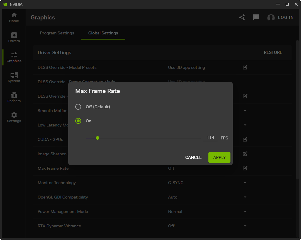

NVIDIA Control Panel/App: <1 Frame Delay
As of NVIDIA driver version 441.87, NVIDIA has made an official framerate limiting method available in the NVIDIA Control Panel/App labeled “Max Frame Rate.”
To set a framerate limit, navigate to “Graphics” in the NVIDIA Ap or “Manage 3D settings” in the NVCP, locate “Max Frame Rate,” select “On,” set the desired limit, and select “Apply,” or “OK,” then “Apply.“
