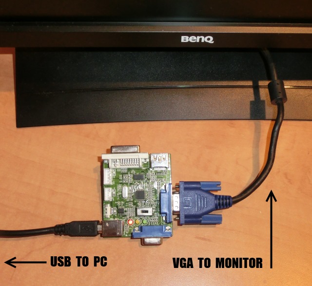

- First, connect a USB cable into the MSTAR ISP device, and plug it into your PC.
Next, connect a VGA cable into the MSTAR ISP device (use the VGA port as pictured below), and plug the other end of the VGA cable into your BENQ Z-Series monitor.
NOTE: You may continue to keep your monitor connected to your PC via DVI or DP cable. It is safe to continue using the same monitor you will be upgrading. - If you are manually prompted for the location of drivers, point it to the drivers within the folder that you unzipped in step 5.

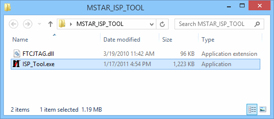

- Now run ISP_Tool.exe inside the MSTAR_ISP_TOOL folder:
- You should see this screen appear:

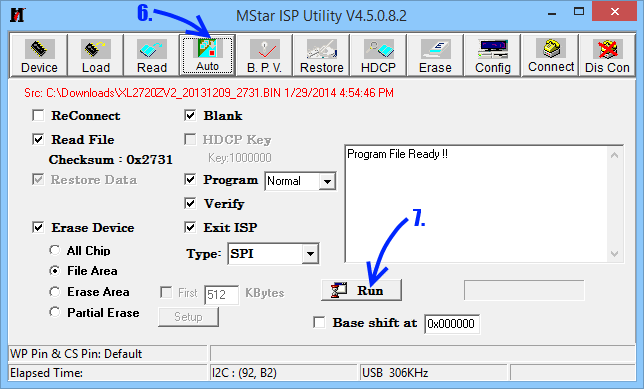

- First, click the “Auto” button.
Then disable the “Reconnect” checkbox.
Then click the “Connect” button.

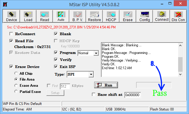

Select the firmware .BIN file that you downloaded and unzipped (in Step 3). - Click toolbar “Auto” button, and then click “Run” button:
- Within a few minutes, your firmware should finish installing, with a green “PASS”.
Your BENQ Z-Series monitor will automatically reset itself, show a purple BENQ splash screen for a few seconds, and then finish powering up. - If your upgrade went successfully, your monitor will begin flashing solid colors in a burn-in test. To turn this off, turn off this mode by press the ENTER button and then RIGHT button on your Z-Series monitor to turn off burn-in mode.
- OPTIONAL: If you want to do an additional verification that the firmware installed successfully, you may access the service menu of your BENQ Z-Series, to confirm. When finished, power cycle your monitor (off-on) to allow Strobe Utility to work.

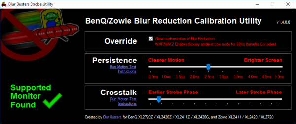

- Download and run Blur Busters Strobe Utility.
You should see “Supported Monitor Found” at the bottom-right corner of the window.
