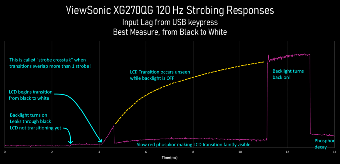

On the XG270QG, with ULMB turned ON, photodiode oscilloscope tests show that the green color channel behaves as a normal squarewave. This is the expected behavior for motion blur reduction.
Photodiode Oscilloscope Test at ApertureGrille.com, Green Color Channel
However, measuring the red channel on the same display shows a distorted square wave.
Photodiode Oscilloscope Test at ApertureGrille.com, Red Color Channel

UPDATE #1: Bonus Annotated Version Of ApertureGrille.com Diagram
Thanks to our familiarity with strobe backlights, we’ve custom annotated an oscilloscope latency test found at ApertureGrille to explain the shape of the oscilloscope graph.
