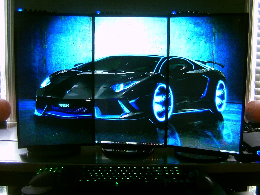

The Amazing Surround CRT-Equivalent Setup
Vega of HardForum set up an amazing surround CRT-quality setup with three ASUS VG248QE and GeForce Titans’s (plus the LightBoost tweak to eliminate motion blur).
1174.,1,0,0,331,256,369,1,0,33,37,1,0,100,0,1943,1935,2144,1283603
This was made possible via a new method of enabling LightBoost (See comments!).  Although TN panels are not good for portrait usage due to viewing angles, fast panning motions remains as perfectly clear (CRT-quality) as stationary images. The CRT-like “smooth as butter” motion apparently outweighed TN panel deficiencies for some users!
