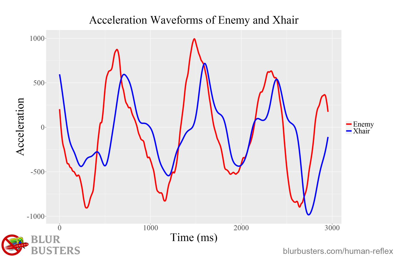

But before we do that, there are a couple things we need to do to the data. First, we need to filter it to remove the high frequency noise. The image processing used to extract the position information isn’t perfect to begin with (if you look carefully in the slow motion video, the red and white vertical lines are a bit shaky). Human movement is also not perfectly smooth, and we want to discount information that isn’t relevant to the question we’re asking. Filtering out this “noise” means we have a cleaner signal to work with.
Second, there’s a problem with using position information as a basis for extracting reaction time. In Quake Live, enemies do not change direction instantaneously. Instead, the game engine incorporates inertia, so that when you press a key to change direction, you decelerate over a period of time before changing direction. If someone is tracking a target that is changing direction, they might be able to notice this deceleration before the target actually changes direction. And this would provide an advance warning, or cue, that could be exploited.
For example, if it takes 200 ms from the moment a target starts to decelerate to the moment the target switches direction, and it takes a player 200 ms to react to a cue, then that player would be able to change crosshair direction at exactly the same time the enemy switched direction. And in such a case, the peaks of the position waveforms would line up perfectly. A solution to this problem is to instead look at the acceleration waveforms.
Here is the same data, but now filtered and transformed into acceleration (in pixels/s2):
Blur Buster's Input Lag and the Limits of Human Reflex: Acceleration Waveforms of Enemy and Xhair

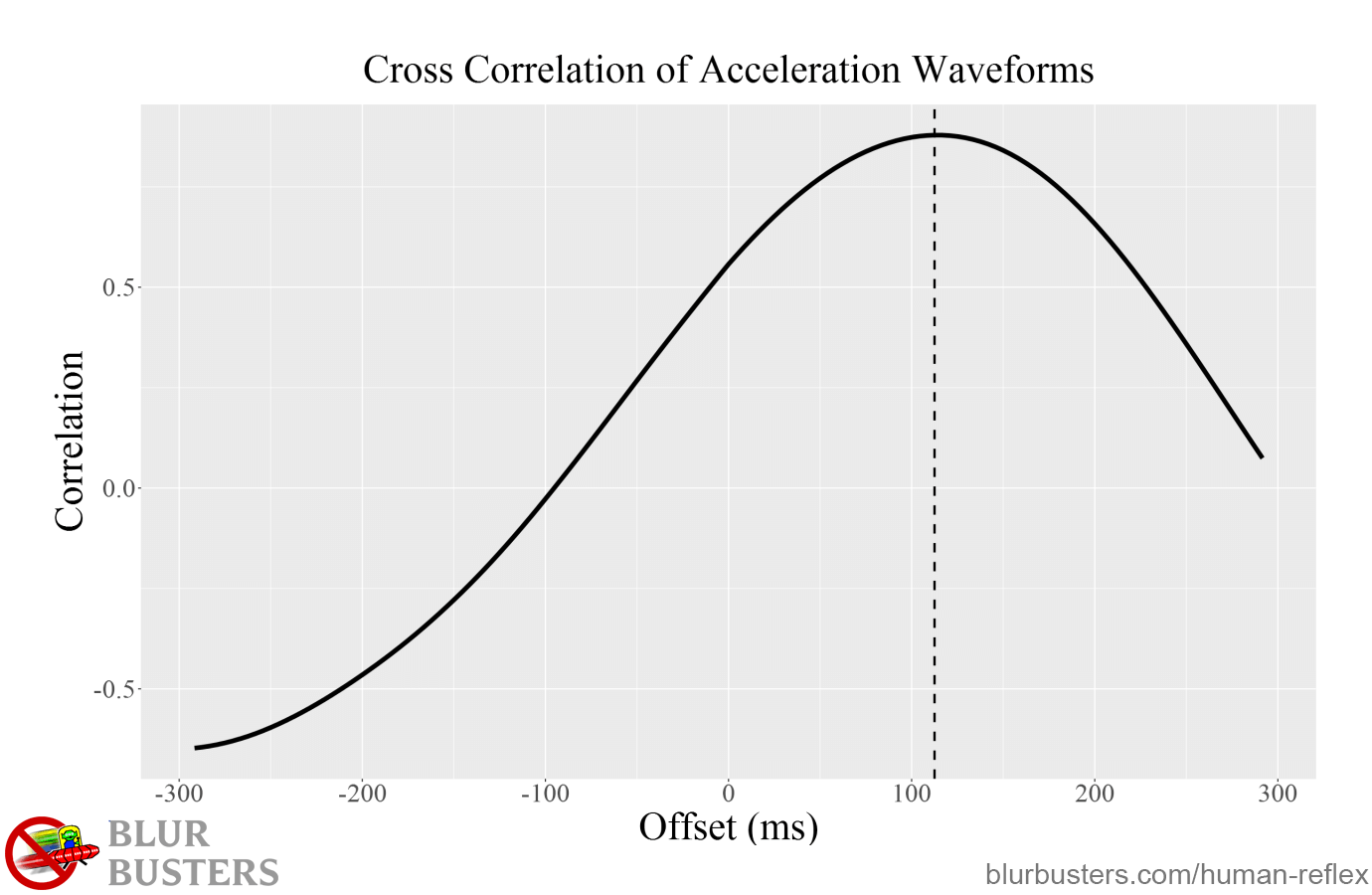

Now we just need to figure out a way to measure the offset between these two curves. One way to do it would be to draw a vertical line at each peak, and count the time between neighboring peaks. It’s unlikely that the offset between each peak would be identical, but we could take an average. A more elegant solution that achieves something very similar is to measure what’s called the cross correlation.
This is a very cool technique that measures the correlation between two signals as a function of the offset between them. So in the above example, if you leave the curves as they are (offset = 0), and measure the correlation between them, you’ll get a particular value. If you then “slide” the red curve to the right by one unit (offset = 1) while keeping the blue curve in the same position, and measure the correlation, you’ll get another value. You keep doing this, sliding one curve over the other, measuring the correlation each time you do this.
Here’s what the result of such a procedure looks like when applied to the acceleration curves:
Blur Buster's Input Lag and the Limits of Human Reflex: Cross Correlation of Acceleration Waveform
This shows the correlation for each of those offsets we talked about. The dashed vertical line shows the offset that produced the peak correlation. This is telling us how much we had to slide one curve over the other in order to achieve the best match. And for our purposes, this is a great way of determining the reaction time of the player. For this frag, this was a value of 112.5 ms, which is a very fast reaction time. (Note: cross correlation is also the technique I used to detect the enemy and landmark positions in the image processed video, except there it was a two dimensional cross correlation, where the “signal” was slid over the image to find the best match).

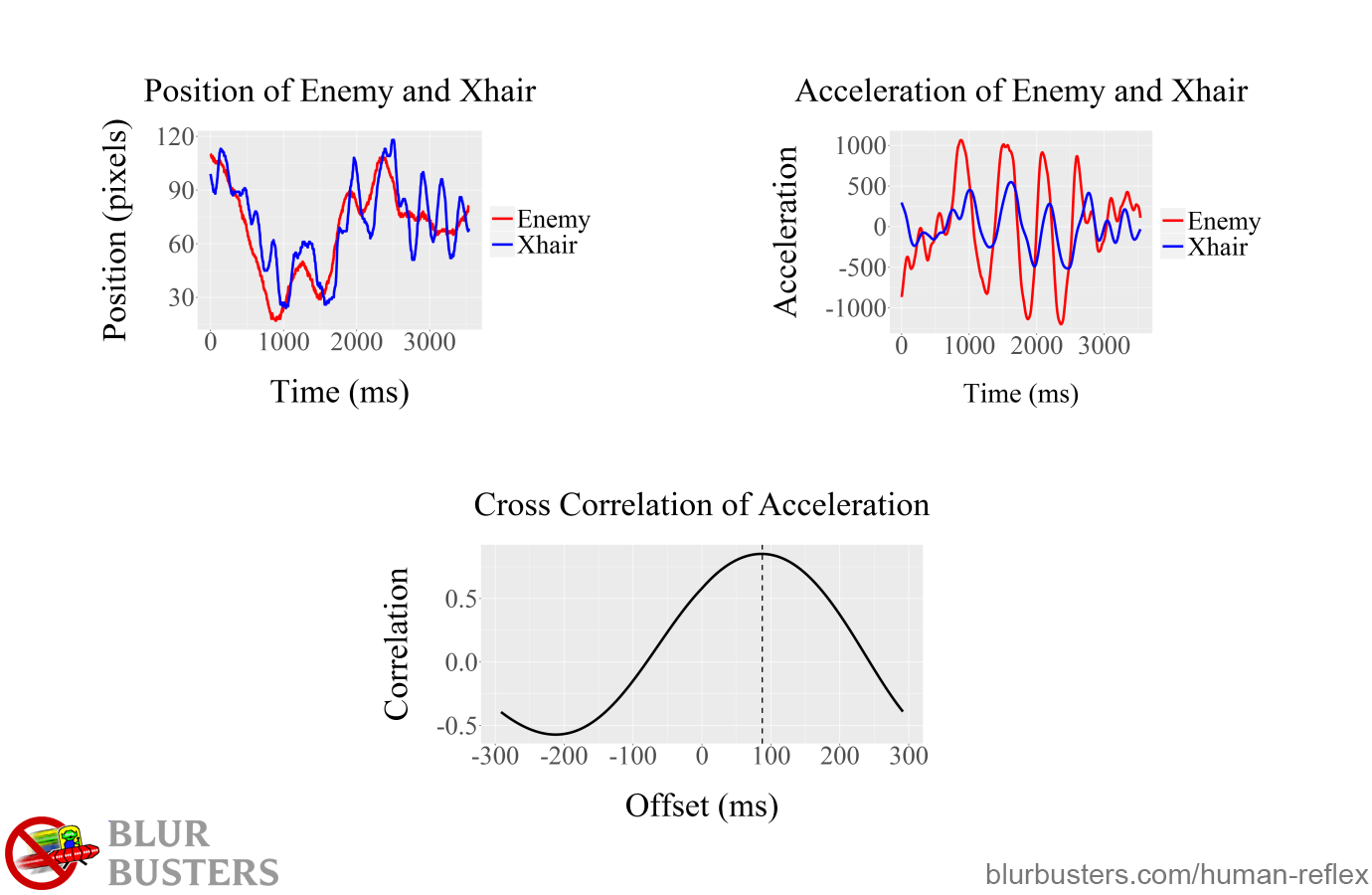

Here’s another example. First the full speed footage:
And now the image processed footage:
Here is the data from this frag:
Blur Buster's Input Lag and the Limits of Human Reflex: Aggregated Frag Data
The reaction time for this frag is 87.5 ms!
