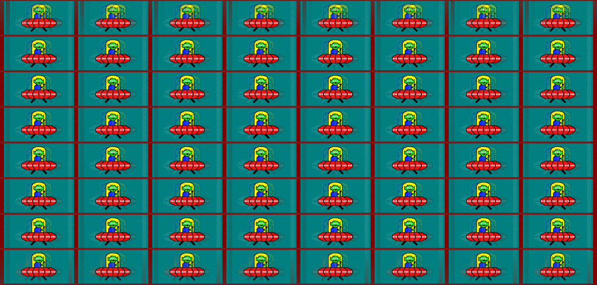

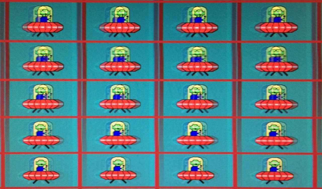

5. Fix strobe crosstalk double-image artifact during fast horizontal motion in bottom half of display.
Before:    After:
This utility adjusts motion quality during fast motion (e.g. panning/strafing/turning) during high frame rates. See before photo & after photo. It provides a wide persistence adjustment range bigger than LightBoost 10% vs 50% vs 100%, including the ability to go sharper/dimmer than LightBoost (10%) or brighter than LightBoost (100%).

  1. A TestUFO motion test will automatically appear. This will help you calibrate.
  2. Persistence will adjust brightness-vs-clarity. Adjust to personal preference.
  3. Crosstalk Area will adjust the vertical position of where double-image artifacts occur.
TestUFO Strobe Crosstalk while adjusting

Crosstalk (also known as “Strobe Phase” or “Area”)
This will adjust the location of the “double image” effects. This changes the location of strobe crosstalk on the screen. While adjusting Crosstalk, you will observe the ghosting zone will shift upwards and downwards. Most users will prefer to adjust until the middle of the screen has the least ghosting.
  Versus
A good setting will improve clarity of high-speed panning motion during high frame rates. You can prioritize with reduced crosstalk versus reduced input lag.
Certain crosstalk band locations will very slightly reduce input lag if the crosstalk band is right below the lag-critical area of your screen (e.g. location of crosshairs). The input lag is lowest in the screen area immediately above the strobe crosstalk band. Real-world performance will usually look better in actual game play. Please note that framerates lower than refresh rate can also cause double image effects.

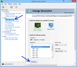

  1. Run either one of the following utilities:
    A) NVIDIA Control Panel -> Change Resolution -> Customize… (if using NVIDIA); or

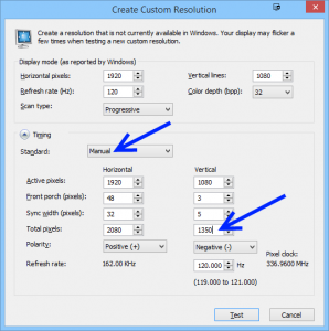

    B) ToastyX Custom Resolution Utility (if using AMD).nvidia-control-panel-customize
  2. Create a new Custom Resolution of 1920×1080 at 120Hz (or refresh rate below 120Hz)
  3. Change Timing to “Manual”
  4. Change Vertical Total to “1350”
    If using NVIDIA Control Panel, edit “Vertical Total”
    If using ToastyX CRU instead, select “Vertical” and then edit “Total”.
    IMPORTANT: If using ToastyX, set Horizontal “Total” to 2080.
    create-custom-resolution-1350
  5. Save the Custom Resolution
    If using NVIDIA Control Panel, Click Test, then click OK, then select 120Hz.
    If using ToastyX Custom Resolution Utility, click OK, and then reboot the computer.
